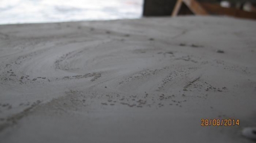

All parts of the project were treated as follows:
1) Cleaning with acetone
2) Masking when appropriate
3) Prekote treatment (scrubbing with Scotch Brite followed by rinsing with water and left to dry)
4) Tak rag to remove any debris on the surface
5) One layer of epoxy primer (International 251, grey colour), left to dry and hardened over night
6) Grinding with sandpaper (400 grit)
7) Rinsed with soap water, clean water and dried over night
8) Takrag to remove debris
9) Two layers of paint wet-in-wet (Sikkens aotocryl, 2 k polyuretane, Old English White)
10) Left to hardened for 4-5 days before handled

Sanding the primer
Sanding the primer
Debris from sanding the wing
