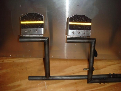

Brief Description:  Finished toe brakes. Fuselage (cont)
Drilled holes for toe brake hinges to final size. Riveted hinge to rudder pedals with A5S rivets. Took 85psi to pull the rivets.
Cut 'anti-skid' pads to fit toe pedals. Peeled and stuck in place. Riveted toe pedals to sudder bar hinges.

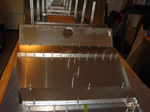

Aligned rear section of fuselage, gear channel and cockpit floor centerlines using a vertical laser level. Once aligned, clamped cockpit floor to gear channel. Drilled and clecoed together starting in the center and moving outward, alternating sides.
Disassembled - removed cockpit floor section to work on center wing spar.
Marked centerline on center section of wing spar.
Marked rivet lines on two lower flanges of wing spar.

Picture showing finished toe brake pedals with anti slip material installed.
