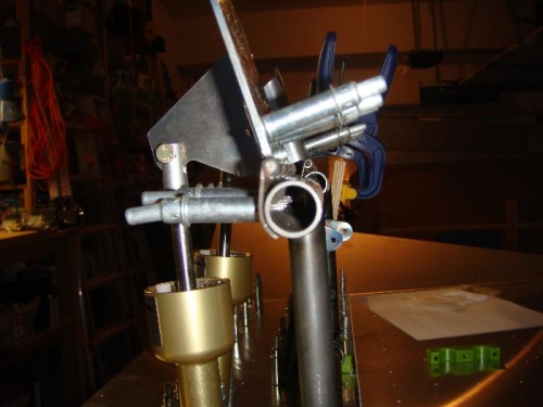

Brief Description:  Rudder pedals
Drilled holes in hinges for toe brakes. Drilled holes in rudder pedals for hinges. Pounded lower edge of hinge to match curve of rudder pedal tube.
Bolted master cylinder assemblies (MC-5) to cockpit floor. Enlarged holes in brake pedals for AN3-7 bolt to MC-5. Clamped hinge and pedal together. Back drilled holes into pedals.
