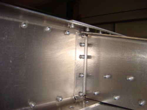

Finished riveting firewall. Had to drill out and redo a handfull of rivets due to access conflicts. Used hand riveter where clearance precluded using pneumatic gun.

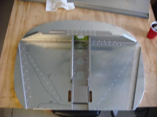

Started on cabin floor. Trimmed heel support to fit. Aligned and fixed with duct tape. Back drilled through pre-drilled holes.
Aligned rudder pedal channel 95 mm behind front edge of floor. Taped in place. Drilled and clecoed front edge.
Quit for day.
Show where extra rivet was added to correct edge distance problem.  Filed bracket arond rivet edges.
Shows edge distance issue at top of gusset flange.
