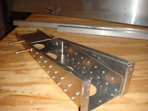

Reassembled pieces to back side of firewall with clecoes.
Reassembled gear gussets to center firewall stiffener.
Reassembled firewall doubler to center firewall stiffener.
Riveted firewall doubler to center stiffener. Pulled rivets from inside (per DVD) to provide a smoother finish for gear bungee. Had to use a hand puller.
rivets pulled from inside to make smooth surface for bugee channel.
