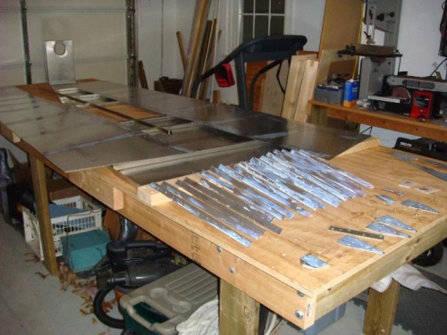

Side aft skins (cont)
Aligned, marked, drilled and clecoed upper rudder hinge. Drilled holes to final size, A5 forward and 3/16" aft for AN3-5A bolts.
Drilled fairing holes to final size.
Disassembled and deburred most holes. Applied anti-corrosive to all overlapping surfaces.
Left to dry overnight.
