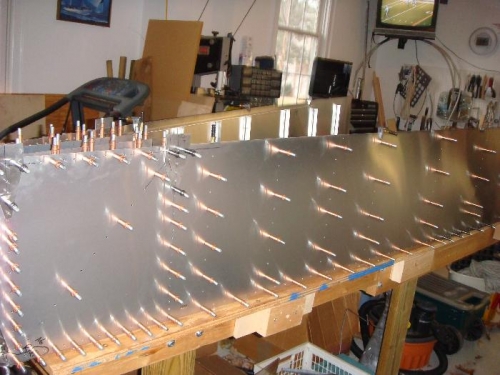

Brief Description:  Side skin small pieces

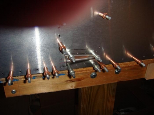

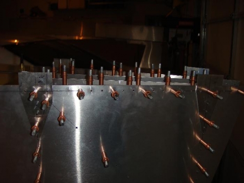

Marked, drilled and clecoed HT attachment brackets in place.
Had to redo diagonal pieces because they were too short to reach bottom aft rivet of the forward HT brackets.
Drilled all holes to final size.
Aligned, marked and cut rudder cable outlet fairings. Drilled and clecoed in place. Trimmed fairlead material to fit. Decided to put material on the inside of fuselage as per Homebuilder.com vice on the outside per the photo assemble manual.
Cut aft most 'L' angles to allow for rudder cable clearance.
