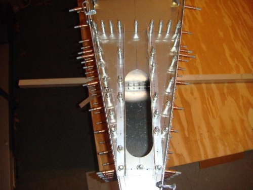

Brief Description:  HT box top flange

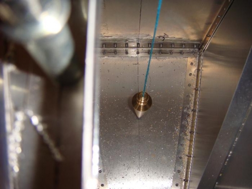

Verified fuselage and workbench were level. Verified fuselage sides were square with bottom. Used plumb bob to verify centerline of 6B3-6 was aligned with fuselage bottom skin centerline. Drilled centerline holes into HT panels. Cut 'L' angle pieces to along sides of opening in 6B3-6. Trimmed to fit inside of upper longerons at aft edge. Clamped in place with vertical scrap pieces to ensure alignment with opening. Drilled and clecoed right side then left.
Trimmed aft edge of upper longerons.
