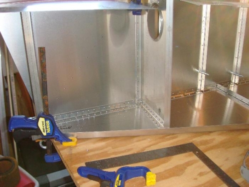

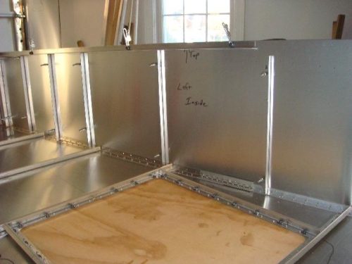

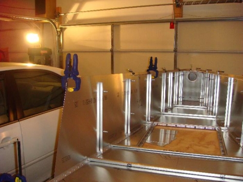

Aligned horizontally side skins with HT frames. Cut 'L' angle upper ends flush with rear longeron. Trimmed bottom of forwad 2 'L's. Rest were spot on and didn't need trimming. Joggled the bottom of the forward 2 'L's. Did both sides.
Aligned left skin vertically with forward tip flush with bottom skin and a small tangental alignment at the rear tip. Drilled and clecoed bottom holes starting at rear and working forward. Verified HT frames were square with the upper rear longeron, drilled and clecoed the side skin to the HT frame. Cut 'L' angle diagonal piece and drilled/clecoed in place.
Reconfigured work bench to work the right side. Re-checked right skin horizontal alignment. Clamped upper longeron in place. Aligned vertically and began drilling/clecoing the bottom holes.
