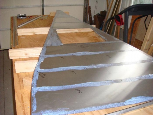

Brief Description:  Fuselage floor
Finished deburring. Applied anti-corrosion coating to inside side of bottom skin along all rivet lines.

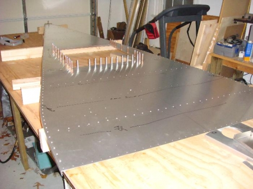

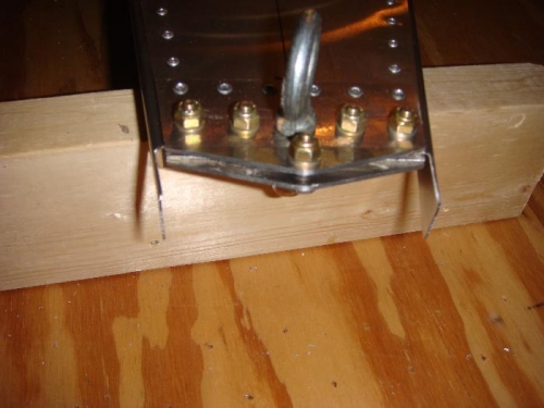

Reassembled rudder hinge while waiting for skin to dry.
Reassembled rest of pieces. Flipped skin over to rivet. Began riveting at longeron splice and worked forward. Then did the front 2 cross pieces (all the A5 rivets). Then repeated with the A4 rivets starting at the splice and working aft before doing the cross pieces. Left the forward and side 'Z' piece around the opening un-riveted to allow for the hinge and door fitting.
