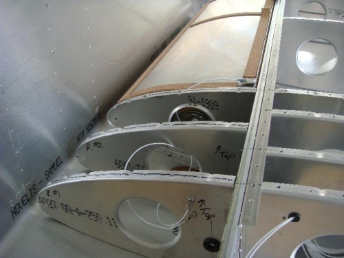

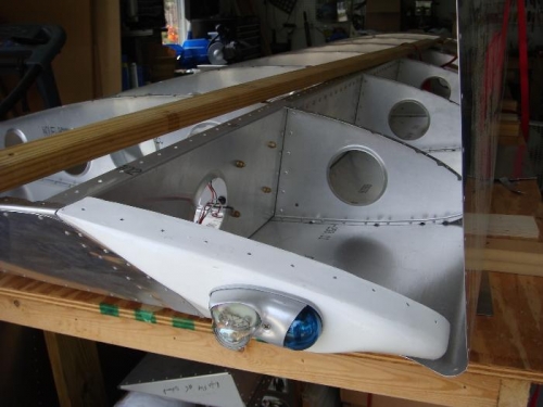

Riveted bottom and aft part of fiberglass wing tip. Riveted navigation light inplace. Connected wires for navigation and strobe lights. Tested with 12V power supply. Fastened fuel tank ground wires to NR #1.

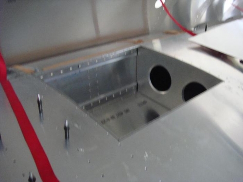

Cut opening for baggage locker and filed sides and spar edge to final size. Drilled holes in hinge. Deburred and filed hinge ends to smooth.
