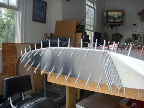

Brief Description:  Right wing tip outter skin.

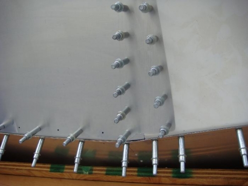

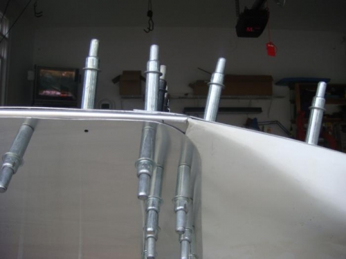

Cut wing tip rear outter skin to shape. Started with rear edge, then top, then bottom and finally the front edge. Tried to make to look similar to left wing but did a better job of cutting at the tangent line of the mounting brackets. Drilled all holes. Found that the 'L' bracket on the wing spar was made too short. Cut a short piece of 'L' material to extend the one installed earlier.
