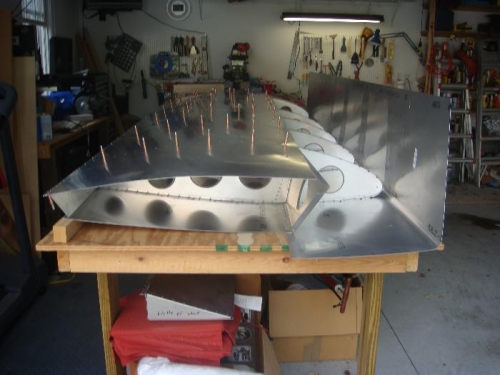

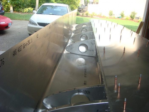

Brief Description:  Finished bottom side of right wing!
Completed re-assembly with clecos. Marked all 'no-rivet" areas. Riveted spar line first, starting in the middle and workinig in alternate directions. Then riveted main spars working from spar aft. Worked ribs in sequence 1 to 9. Lastly, riveted nose ribs also in sequence. Cut hole for fuel filter access between nose rib 2 & 3. Mounted nut plates on aileron horn access cover. Mounted flap in place with clamps. Then drilled holes in piano hinge, starting in the middle and working outward alternatively. Removed flap and flipped wing rightside up. Clecoed top skin inplace. Laid out straps for working the top side nose skin. Quit for the day.
