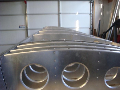

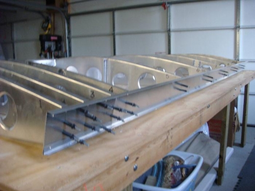

Brief Description:  Rigth wing shell (cont)
