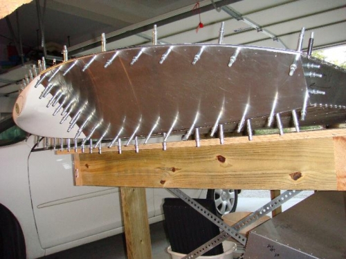

Date:  11-4-2007
Number of Hours:  3.50
Brief Description:  Left wing tip
Drilled and clecoed top edge of aft wing tip skin. Then front and aft edge. Trimmed bottom edge to final size. Drilled and clecoed all. Refit nose piece. Finished by drilling holes connecting aft skin to fiberglass nose piece. Bottom wing skin still needs to be trimmed to final size to create a nice rounded finish. Currently too sharp.
