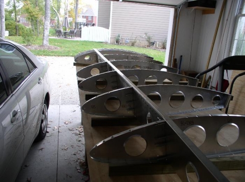

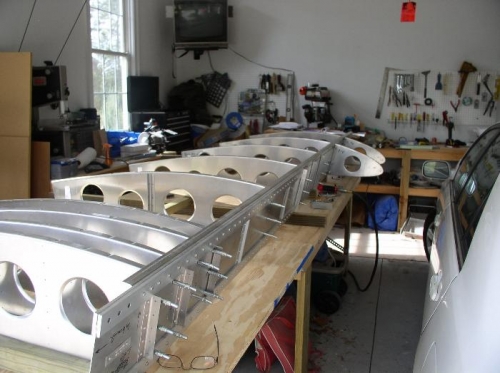

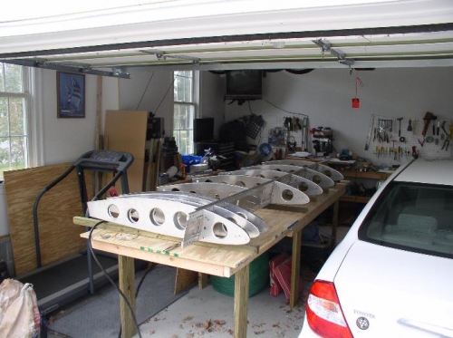

Number of Hours:  3.00
Brief Description:  Left wing (cont)
