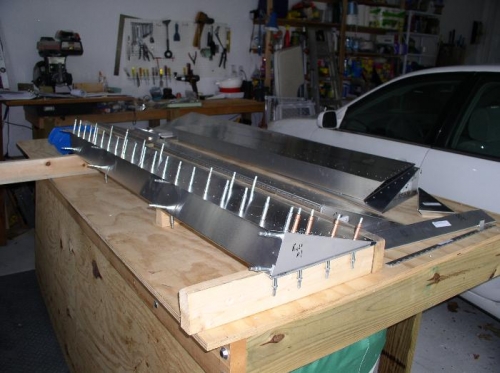

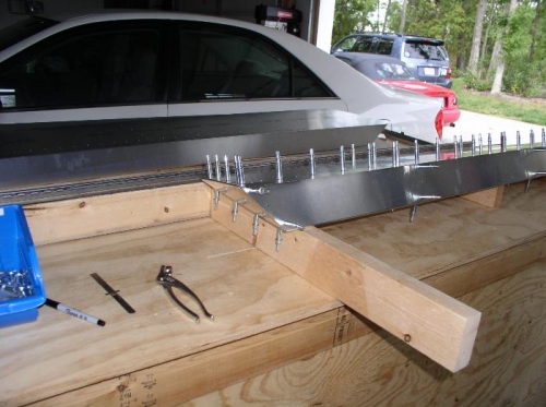

Brief Description:  Drilled and clecoed right aileron.

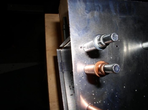

Propped aileron on 2x4s with 13mm block under outboard trailing edge. Drilled holes for top of spars. Then started on leading edge line. Edge distance appeared close but tolerable. Appears that the first hole on inboard edge was improperly drilled by the computer. Should be 15mm edge distance to allow for the recessed spar. Hole is 10mm from edge which puts it too close to the curbed edge of the first spar. Marked and drilled the hole at 15mm. Not sure what to do with the hole Zenith drilled for me.....
