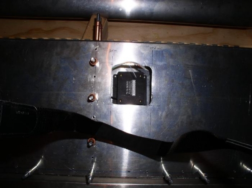

Brief Description:  Elevator Trim servo installed.
Cut hole for servo rod. Mounted trim horn. Cut rod to length. Tested servo with 9V battery. Installed servo. Trimmed access cover. Drilled and clecoed cover inplace. Drilled all holes to final size. Disassembled and applied anti-corrosion. Drilled 7/16" hole for routing trim 5-conductor wire. Inserted rubber grommet.
