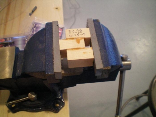

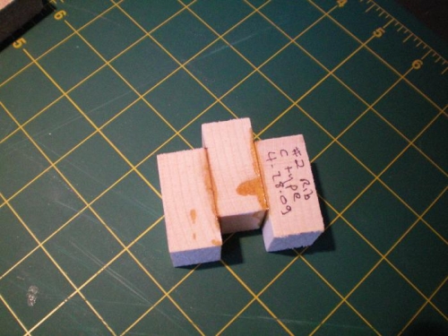

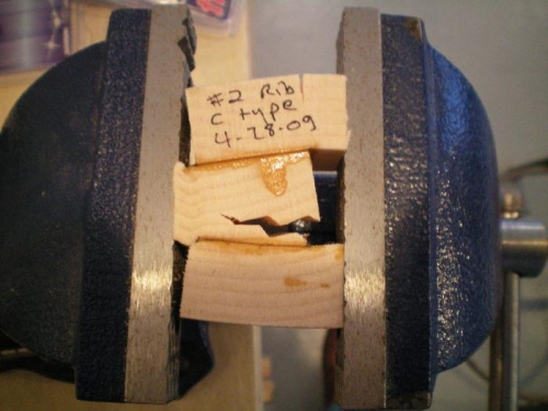

It's a good practice to make test blocks for each batch of glue you mix up to build the plane. I use pine wood (locally available, cheap, and has similar porosity to spruce) for my test blocks. They are 1 inch square and about 3/4 inch thick. I use the glue fromt he end of the batch, put some on the surfaces of the test blocks, and treat it as I would the final airplane part. It gets numbered and annotated so I know what it was for. A week later, I put it in a vice and test it to failiure. The glue joint should remain intact and the wood should break.
Success! The wooden blocks broke right where they were supposed to. And the glue joint remained intact.
Assembled test block.
Test blocks ready to test to their breaking point.
Glue joint intact, the wood has failed.
