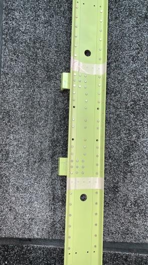

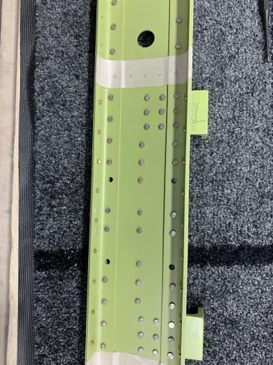

Manual Reference:  8-6 step 1-2
Brief Description:  HS Rivet HS Doubler, Front spar caps and bracket t
Preassembled front spar with HS-1002 with front spar caps HS-10013 and front spar attachment brackets HS-1008 L&R.
Rivetd with different types of rivet depending on thickness of material. Final drilled few holes to #30.
All the rivet have been set using the pneumatic squeezer with very good results.
