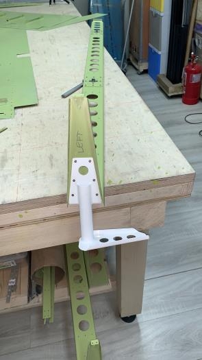

Manual Reference:  9-B(11) step 1-2
Brief Description:  ELEVATOR rivet reinforcement horns and root ribs
Backriveting of the reinforcement plates to the elevator bottom skins. Lucio teaching and supervising. Marco preparing parts and positioning during back riveting
Backriveting of all the ribs halves to the skins
Lucio took care of riveting the E-1007 rear spar (only one side and only up to the trim section-
Further work pending to complete step 3
