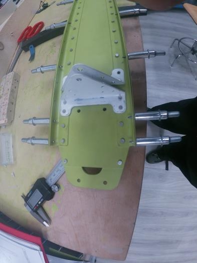

VS assembly rudder, blind rivet stiffener
prepare aluminium angle as reference for trailing edge.
Apply 3M doubleside tape to both sides of trailing edge R-1006 wedge.

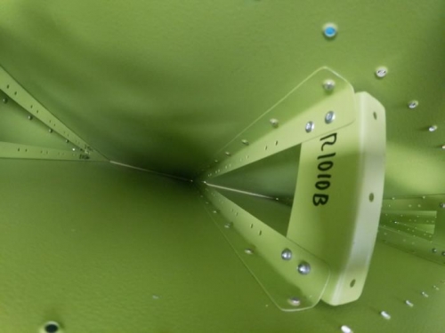

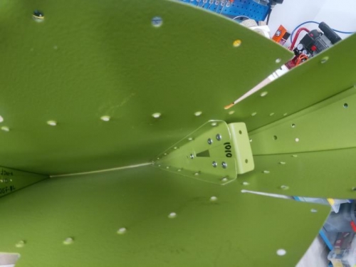

Rivet stiffener and shears clip R1010A-G Left and Right to R1005A-G using LP4-3 blind rivets
. Cleco skins, trailing wedge and aluminium angle reference together.
Clecoed every single hole.
Add weights to the 4" board on top of rudder.
