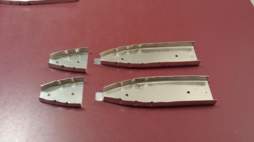

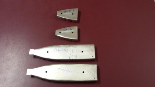

Brief Description:  Formed some of the tail rib parts
Formed some of the tail ribs. Will complete the rest tonight. I had trouble getting the T04-05 to straighten until I put the 3rd flut in the metal. The plans don't call for the 3rd flute but both were bowed quite a bit with only 2 flutes. I spaced the extra flutes so that it won't interfere with rivet placement so it should be ok.
