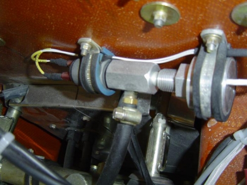

Brief Description:  Fuel Pressure Gauge Sender
From advice from Andy Draper from LAA I decided to fit a fuel pressure gauge, alongside the Fuel Quantity, The pressure sender gives a reading to a gauge and the pressure switch to operate a warning light. This will give early indication of a problem in fuel flow (Blocked Fuel filter etc.) Pictures in the Panel Section.
