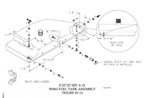

Drilled five 1/2 diameter holes for the fuel fittings, for this I used a Uni-Bit drill, at the locations shown on figure 05-14.

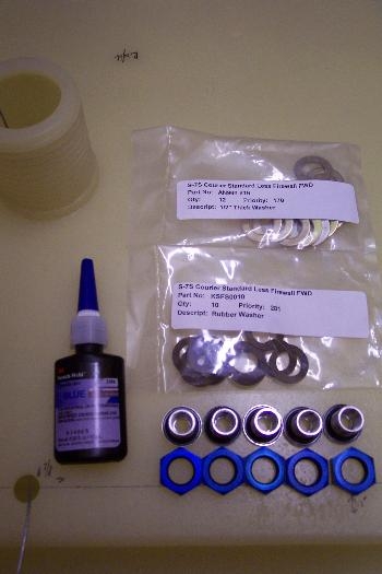

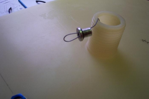

After the tank was completely dry I started installing the fittings. To install the fittings into the tank I used a rigid metal wire which was inserted through the filler neck and out of the fitting hole.
Each tank withdrawal fitting received a O-Ring to seal the inside of the tank.
The outside of the fitting received a flat rubber washer, 1/2" thick washer and a retaining nut.
Locktide blue was applied to the threads.

Fuel Fittings
Fuel Fittings
Metal wire
Metal wire
