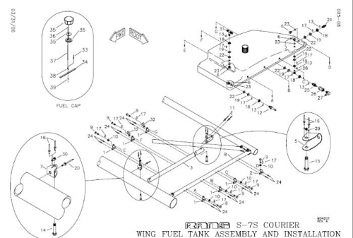

Manual Reference:  05B-01
Brief Description:  Fueltank Assembly and Installation

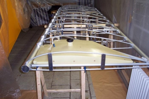

Drilled and riveted a single-ear nut plate to the top of the S2-SAB bracket.
Installed the outer tank support.
Drilled two holes in the U- Bracket. Bolted the U-Bracket to the support tube and fastened the U-Bracket with two stainless steel rivets to the drag brace. Installed the 3/16" nut plate to the topside of the U-Bracket.
Righthand wingtank
Righthand wingtank
