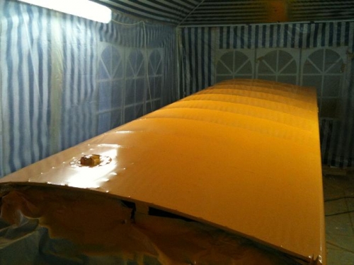

Brief Description:  RH Wing final Color
Cleaned entire wing with C-2210 paint cleaner followed by a tack rag to collect last minute dust.
Mixed the yellow Polytone with reducer 4:1
On both sides we first applied a mist layer and let this dry for a few minutes. Then sprayed both sides, this time without any runs.
This year august is very wet, it rains almost every other day which brings lots of humidity and delay in the painting process. Whenever I have a day off it rains.
I have to spray the righthand wing once more, the yellow did not cover to my satisfaction.
