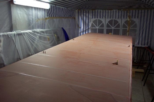

LH Wing Bottom Riveting
Applied the small double stick tape on top of the fabric centered along each rib and extending 1/4" past the first and last hole.
Cut lexan straps to lenght and glued on the cover strap centered on top of the rib holes.
Used a hot soldering iron and melted through the cover strap and the fabric into the rib hole.
Cut the melted build up on top of the lexan straps with a racer blade.
Inserted about 160 rivets on the top surface and riveted.
2 Way Tape
160 to go
Done
