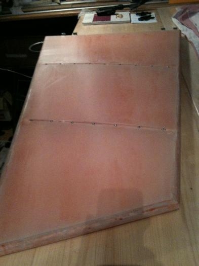

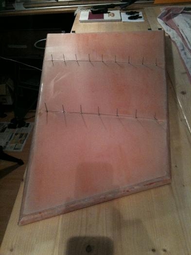

The fabric needs to be riveted under the reinforcement Lexan strip to the center of each rib.
Applied clear double stick tape on top of the fabric centered along each rib.
Used a soldering iron and melt through the cover strap and the fabric into the rib holes.
Riveting
