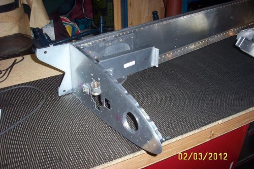

Updated drawings with the Revision Log dated Feb 1, 2012. Downloaded dwgs ONX-F13 rev A, ONX-F22 rev A and ONX-L04 rev N/C (with L04-05 inclusion) and had the C-size drawings printed at Staples (~$3 each) and added them to the drawing package.
Unpacked the left outboard main spar (-W11) and started checking the assembly of components on dwg -W09. Checked the pivot bolt/pin holes (-W05) and the need for reamers. Measured the AN6-14 bolts I have at .3720 dia which is within the drawing spec of .3715-.3720. Checked the LH outboard spar holes and they have already been reamed, so I won't need to go shopping for a couple of reamers.
Checking LH outboard spar
