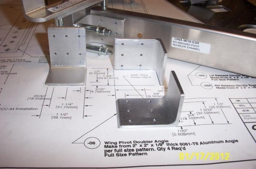

Made (4) W19-06 wing pivot doubler angles from 2x2x1/8 angle provided in the kit.
Bent ends of W19-03 L/R inboard and W20-03 L/R outboard doubler channels.

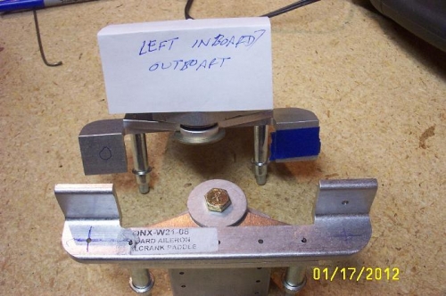

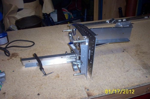

Assembled various right side inboard and outboard paddle assembly components to determine correct placement and which paddles need drilling. In addition to changing some of the tapped paddle adjustment holes, the hole for the inboard aileron linkeage needs to be repositioned on some of the paddles. The 3/16" hole is at the end opposite the adjusting screw (aft end).
Fabricated W19-06
Fabricated W19-06
New linkeage and adjusting holes needed on left paddles
Right side inboard/outboard assy
