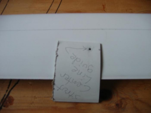

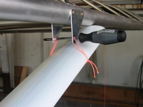

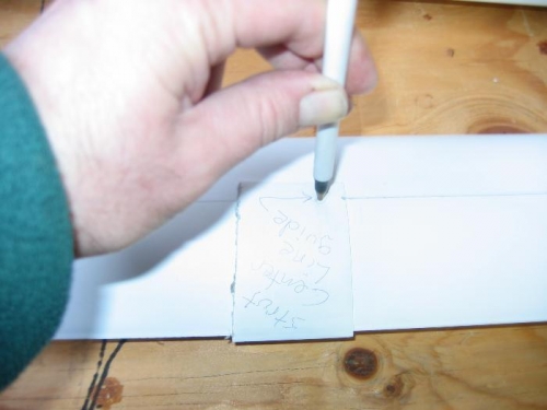

I found that sliding cut of section of streamlinged strut fairing with a hole made half way made short work of making the eight sides of fairings. Cutting out the bottom for the ronny bracket was easy with a cut off tool. Not sure how to end the top
