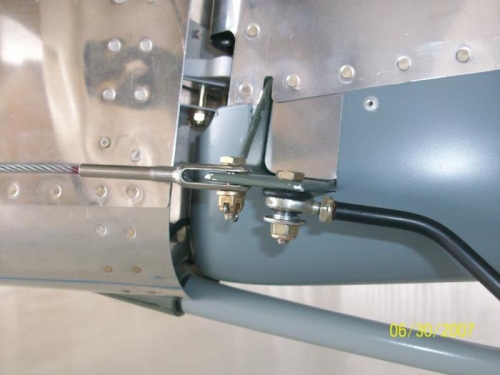

The bolts and castle nuts attaching the rudder cables to the rudder horn were tightened and safetied with cotter pins.

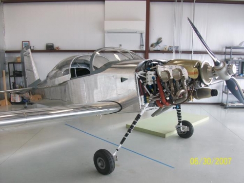

The plenum was installed without the tubes that connect it to the cowl. This will be beteer for running the engine on the ground and will provide more even cooling.

Plenum installed
Plenum installed
Rudder horn bolts safetied
