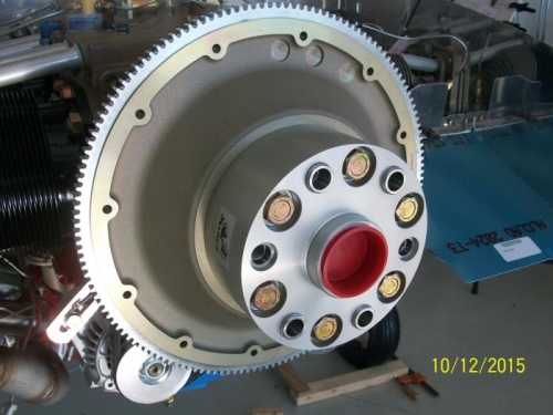

Next I removed each prop spacer bolt, one at a time to apply Locktite and then retorque. This was done sequencially for each of the 6 bolts.

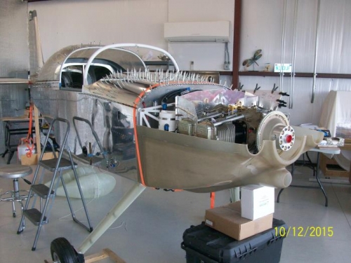

I then began work on fitting the lower cowl. A template was cut for the gear leg exits and this pattern was transferred to the cowl corner and the cowl cut. I also made up a carboard template to simulate the back of the spirrner.

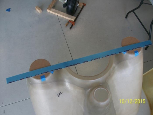

The horizontal centerline was drawn on the lower cowl front and established using a sanding block. The colw was fitted to the fuselage. This has taken several iterations to adjust the gear leg cut outs, adjust the exhaust/muffler pipes to provide clearance, adjust clamps, and so on.
Spacer bolts Locktight and torqued
Marking centerline on lower cowl
Lower cowl trial fitting
