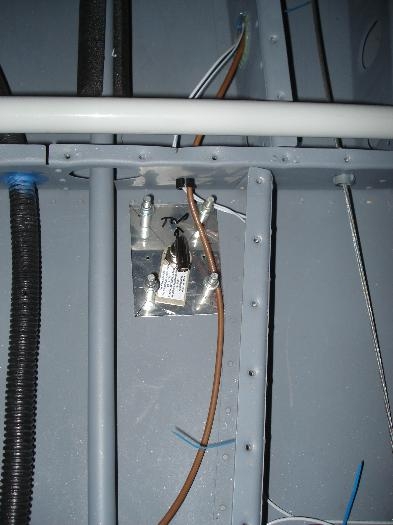

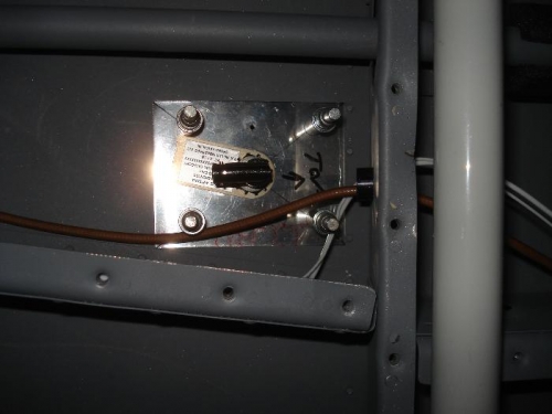

Date:  1-22-2015
Number of Hours:  1.50
Brief Description:  Transponder installation #1
After verifying the location and distance from the comm antenna, I decided to locate the antenna behind the rear seat and under the baggage compartment.
I created a doubler, verified the hole size and matched drilled to the bottom of the skin. I also matched drilled the rivet holes.
I will have to remove the primer from this location and dimple the holes before moving forward.
