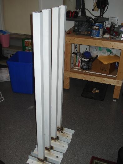

Brief Description:  Welded the wing stands

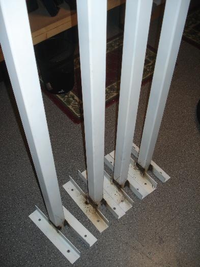

Tonight I got around to finally welding the feet for the wing stands on. I picked up four pieces of 1/4 inch thick 2x2 steel, measured out at 54 " in length. I also had eight pieces of 2 " angle cut to 1 foot lengths, drilled the holes to 3/8" for mounting and welded them on tonight.
I have to clean them up a bit, prime them, and then will paint them a bright yellow.
The hardware should be on by the end of the weekend. I will have to anchor them into the garage floor, but will wait until the wing kit is almost here before I do that.
