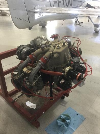

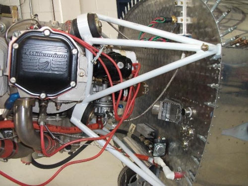

Brief Description:  Sump replacement to a Cold Air Superior Sump #3
The Silverhawk fuel injection also had to some off the old sump. A new gasket was added and the servo was mounted.
Prior to mounting, the inlet was reversed on the servo. The Lancair it was on had the fuel inlet line on the opposite of where it needs to be in the 8.
With changing the inlet to the other side, the internal filter must be reorientated to the other side as well. It was re-safetied wired and completed.
All done
All done
Fuel servo re-installed
Back on the mount
