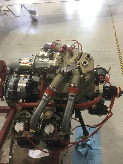

Sump replacement to a Cold Air Superior Sump #2

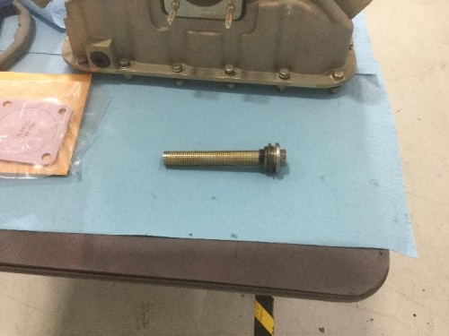

I removed the oil screen from the oil sump and installed it in the new sump. I was surpsied at how clean it was.
With the new sump, all new lock washers were installed and the bolts were torqued to specs.
I'm going to wait to see where the exhaust will sit once it's installed before I make a decision on a quick drain plug for the oil.

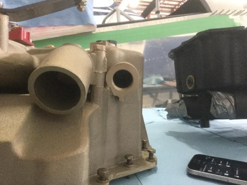

Clean oil screen
Oil screen port.
