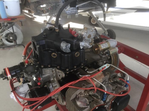

Brief Description:  Sump replacement to a Cold Air Superior Sump #1
When I acquired the engine, I didn't know that the sump was a Ryton sump. I knew it wasn't a standard sump, but was surprised to hear from Clint at Vetterman about the issues with it. I sent photos of the sump to Clint when ordering my exhaust and he picked it off.
I contacted Superior and to their credit, the replaced the sump for free.
I pulled the engine off of the mount and oput it back on the engine stand and prepped it for draining. I purchased a brand new clean bucket and drained the inhibiting oil.
Rolled it upside down and removed all of the nuts and bolts and cleaned the old gasket off.
The old Ryton sump
The old Ryton sump

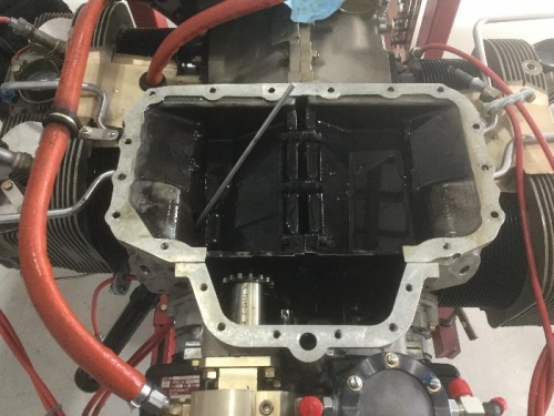

Sump removed and cleaned up.
