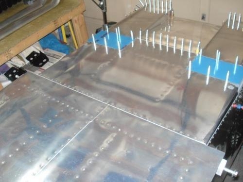

Finished up installing the right and left bottom forward skins.

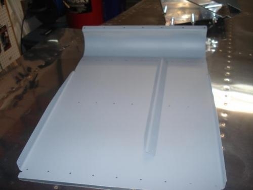

Finished deburing the cooling ramp and stiffener, cleaned, primed, then dimpled.

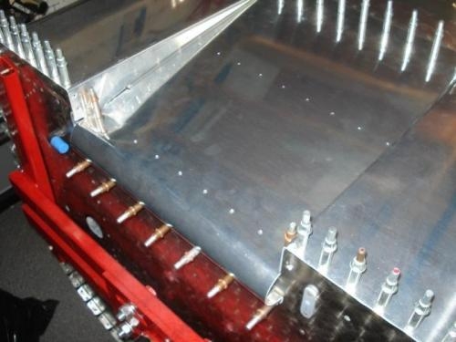

Back riveted the stiffener to the cooling ramp and then mixed up some proseal.
Added proseal to the contact area where the cooling ramp meets the bottom skin and the cross brace for the gear box area.
Used blind rivets as per the plans and riveted the cooling ramp to the flange.

Front left and right bottoms skins
Cooling ramp clecoed in place
Cooling ramp primed
