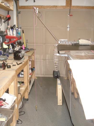

Matt Dralle used the angles and bolted them to the axel holes and then added a square piece of particle board to make sure that the gear was parallel to each other. I will do the same.

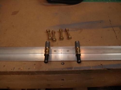

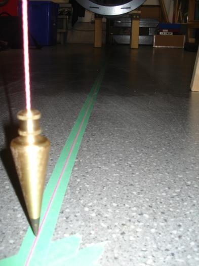

What I also did was clamp to two pieces of angle together, found the centre and then drilled for the 1/4 bolts for the axel holes. Once that was done, I then measured equal distances (23 inches from the centre) for and aft and drillled a #30 hole for the plumb bob line. I know that the distance from the centre of each gear leg is exactly the same, which will hopefully make my calculations that much easier..we shall see.
I bolted up the angle to the gear and then added the plumb bobs. Tomorrow, I will get a piece of particle board cut square so that the width is 65 11/16 inches (it worked for Matt) Once the gear are confirmed square to one another, I will then draw my parallel lines from the centre line and get the parallel gear, in parallel to the fuselage lines. Make sense?
