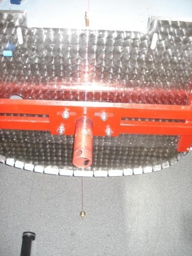

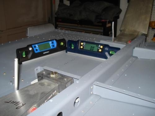

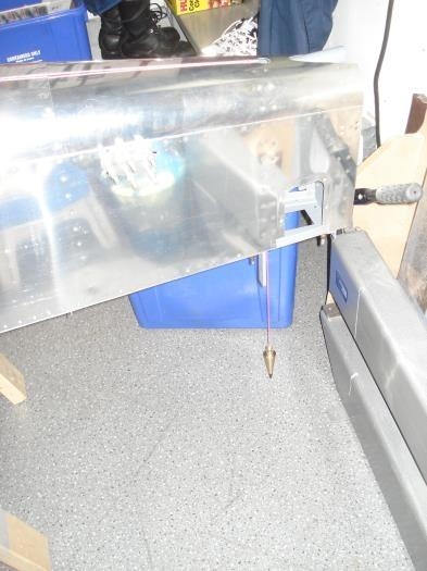

Once on the saw horses, I went back and forth to get the fuselage level laterally and longitudinally. Once that was done, a ran a sting from the firewall to the tail and then added the plumb bobs.

F-822 Bottom skin level laterally and longitudinally
Plumb bob in the centre line off the firewall
Plumb bob off the centre line in the tail.
