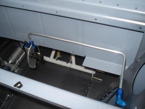

Straightened out a few feet of brake line from the roll and measured the distance from the fitting 90 degrees to the bulkhead and then to the parking brake fitting for both sides.
Cleaned up the brake line and removed all burrs and then flared the end.
Couple of 90 degree bends were made and the fitting and flare completed for each side.
I'll add an adel clamp to each line on the bulkead for security.
The left side brake line is about 1/2 inch higher than the right...might have cut it a little and get both lines even...anal, you bet!
Flaring the ends
Flaring the ends

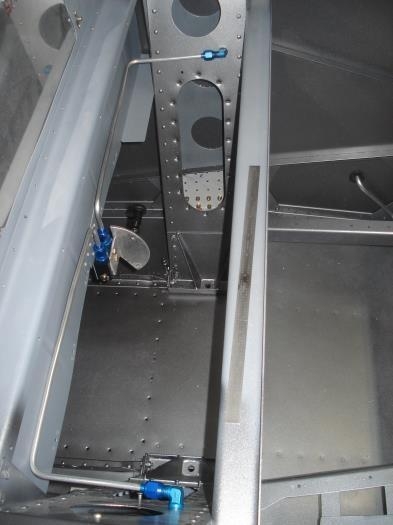

Right brake line completed and attached to the gear tower
Both brake lines in place
