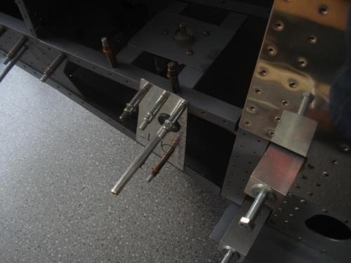

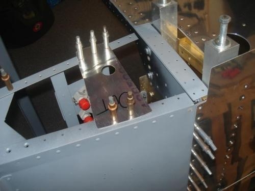

Didn't spend a whole lot of time in the garage, but I made an easy template out of some scrap aluminum and matched drilled to the left skin where the fuel line exits the fuselage.

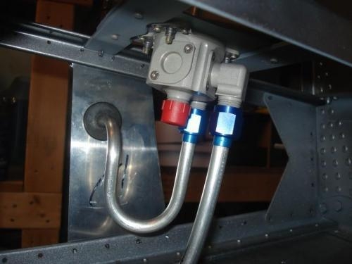

Took a short piece of fuel line, made a 180 degree bend with the tube bender, measured, cut to size.
Filed the flared end smooth and then used the parker flare tool and made a nice flare. Checked for fit. Much easier than the right tank.
Template for the left tank fuel line exit made
Left tank fuel line flared, fitted and good to go
Left tank fuel line fuselage exit.
