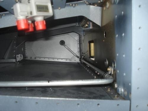

Had lots of fun with this one.
The third try at the right tank fuel line proved to be it. Once I figured out the diameter of the bend and how it had to be measured, I was good to go.
The first line I measured right, but bent at the second line i drew, I bent too far of where I needed and had to set aside both lines for future cutting and use.
Happy with the fit and it doesn't touch the floor and all four adel clamps were temporary installed. This line will come out so that I can rivet the bottom and left side skin.
Right tank fuel line started

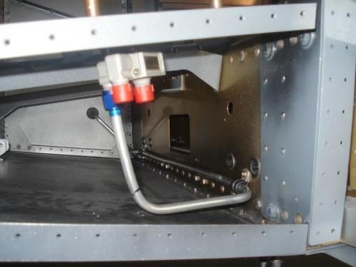

Along the spar box
Along the spar box
Flared, fittted, and good to go
