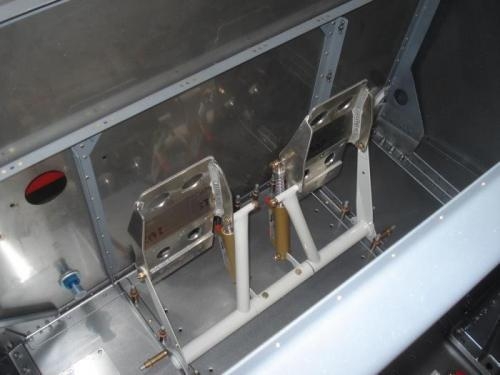

Brief Description:  Rudder pedal assembly #1
Measured the brackets for rivets, drilled and then deburred and primed and painted.
Brackets were riveted to the floor, but not riveted to the landing gear box (1 hole in each bracket)
Pedals tested for fit. The return springs will have to be adjusted down the road and I'm going to send the pedals out to get a black textured powder coating to assist with foot grip.
Rudder pedal brackets drilled
Rudder pedal brackets primed and painted
Brackets riveted and rudder pedal assembly checked for fit
