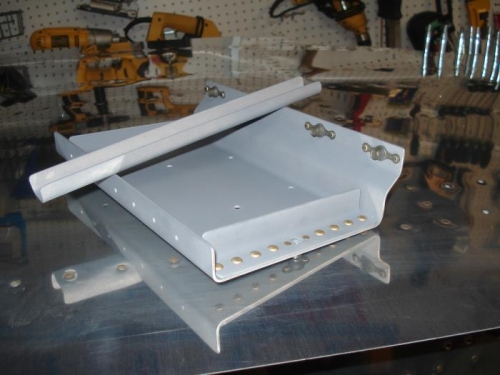

I've decided to mount the vattery box in the rear.

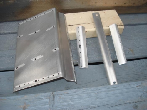

Parts were gather, deburred, cleaned and primed.
For some reason, Van's doesn't seem to supply any AN470-3 rivets for the callouts in certina areas. Noticed this also on several build sites. So I modified the call out, countersunk the holes for teh plate nuts and added AN426 flush rivets.

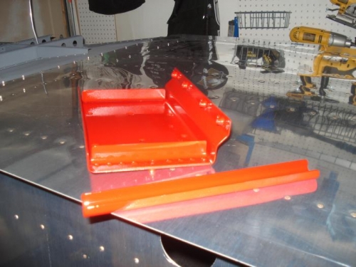

I also painted it...Red.
Deburred and cleaned
Primed and riveted
Primed and riveted
Painted.
Painted.
