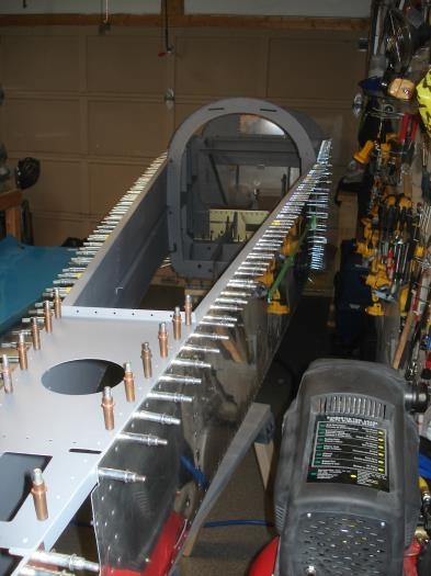

Nutplates riveted to the aft side skins for the cover plate opening.
Nutplates riveted to the mid longerons.
Back riveted the left and right mid longerons to the side skins.
Side skins clecoed to the F-807, and the upper longerson.
Rivets taped in place for teh vack riveting of the mid longeron
Mid longeron back riveted into place
Both side skins clecoed into position.
