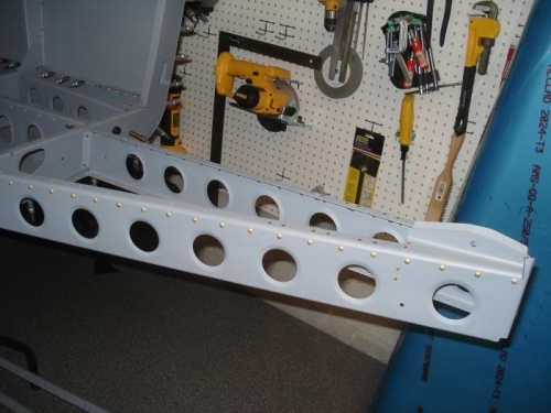

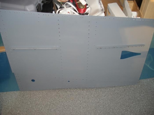

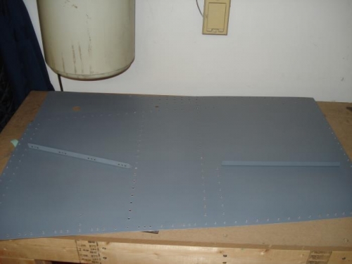

Back riveted the throttle quadrant angle and F-870B-1 stiffener on the left skin and the throttle quadrant angle and the F-870E-1 to the right skin.
Attached the nutplates to the throttle quad brackets, and the baggage ribs. Clecoed the F-807 bulkhead in place and attached the baggage ribs after riveting.
