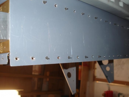

Removed all of the fuse pieces off that weren't required for the next few steps.
I removed the seat rib assembly and clecoed the forward fuse floor to the front and rear flanges of the centre section.
I machine countersunk the #30 holes in the two rivet lines to accept a #30 dimple.
I then removed the front skins and reclecoed the aux longeron.
With the Andair fuel valve, the next step doesn't work with the F-883-1, so I'll have to devise a bracket system for the fuel valve.
Bootom skin #30 holes on the entre section machine countersunk
Need to touch up the primer here.
